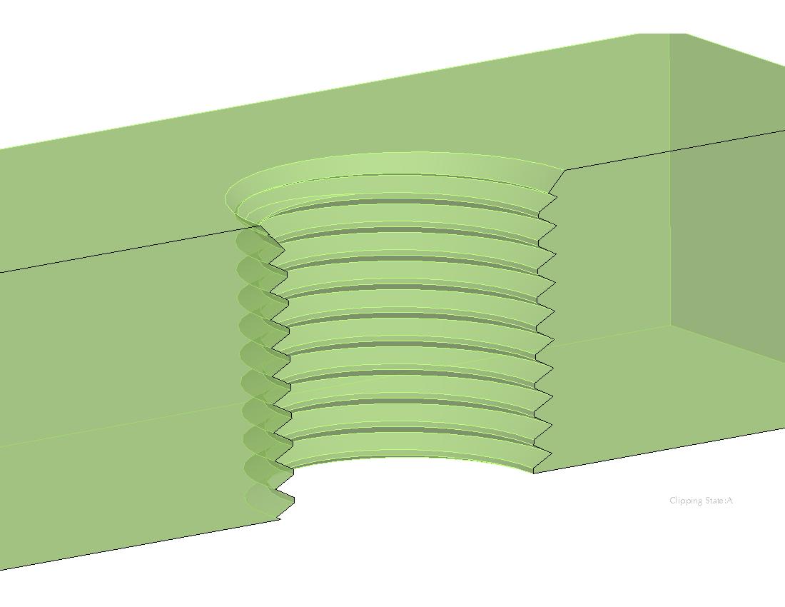

July 8, 2010
Hi
Its more something like this I want, but with Gass-threads.
See attachement
Chris

chris51-VisitorAuthor
July 12, 2010
Hi
I suppose you are close to have given the right answer but...
I can not open the files you send along (hol) the pc seems to think it's a kind of file like "holidays of microsoft office outlook".
Is it possible you did something wrong or did I? I send one unzipped back.
I should say or you try it again or you tell me what i've been doing wrong.
Thanks anyway
Chris
July 12, 2010
This files have to be placed in the same directory as iso.hol and unc.hol.
You then need to restart proe. you should see different choice of thread in the hole tool.
If you want to create your own thread you need to edit this files with pro-table.
Nicolas
