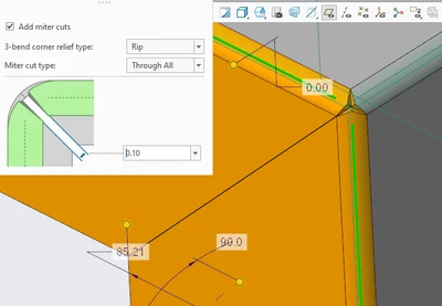

Creo Parametric does not have a standard workable way to work with three bend corners
There are some workarounds, but all have issues. I work with Creo 10.0.4.0.
This is my search for a good three bend corner which can be welded.

Option 4
Option 4a
Create two bends with Flat feature
Use miter cut with 3 bend corner relief Rip

Conclusion
Creo lacks good functionality for three bend corners. None of the options are good.
Does anybody have a better way? It needs to be welded nicely (and sometimes watertight)

Have you tried flange with extruded relief?
Created in Creo+ (Build: 11.0.0.1-001).  Same results as Creo 7.0 trial.
