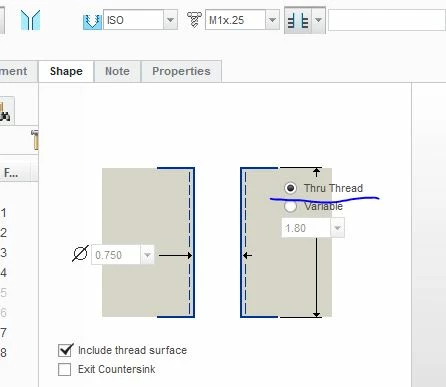

Hello
I have created a tapped hole in Creo part file. Once I go to edit definition -> Shape, I am able to find option for through thread. Option is disabled for me. Any idea how to enable the same?
Thanks and Regards
Ketan
Jan 17, 2018 6:59 AM UTC
That may be due to "Upto Surface" depth that you have selected for the hole. As I know you can't make the thread depth and the hole depth dependent. Thru Thread is enabled only for a Thru All hole.

Jan 16, 2018 10:42 AM UTC
Hi, You're looking in the wrong place. See attachment. Use the pulldown for up_to_next or Through_all etc
2-Explorer
Jan 16, 2018 11:24 AM UTC
Hi, Thank you for response. Actually what you have mentioned is for hole depth. I am looking for through thread depth. In other words, Suppose I have selected surface such that depth is 200.Now, I want 200 as thread depth.I can provide value as 200 for variable option, but how to achieve 200 as Through Thread? Variable I guess will not increase thread depth if reference surface used for through hole depth is updated.
Jan 16, 2018 11:29 AM UTC
see attached
8-Gravel
Mar 6, 2025 6:59 PM UTC
In CREO 10, to selected depth option with thru thread is available under the shape tab, icon is actually a super secret drop-down menu.
