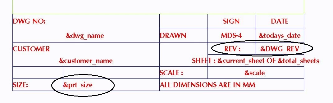

can anyone help me in creating title block / format in creo 3.0
i'm facing problem in getting the dimensions & rev number in the title block after creating drawing file with format.
Dec 28, 2018 1:59 PM UTC
Windchill or native filing?
The rev parameter is driven from Windchill or just entered if native.
Haven't done part size dimensions, but my guess is you will have to build it using relations after getting the XYZ values.
