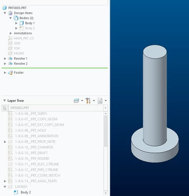

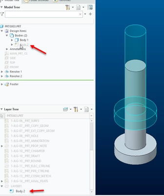

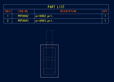

You can use a combination of construction multibody and layers.
Assembly shows the one for each component.
Drawing shows a correct BOM quantity but the second component it is shows as double.
The individual components when is open looks as a single component.
But I have a second body which I controlled using layers.
Let me know if this works for you!
