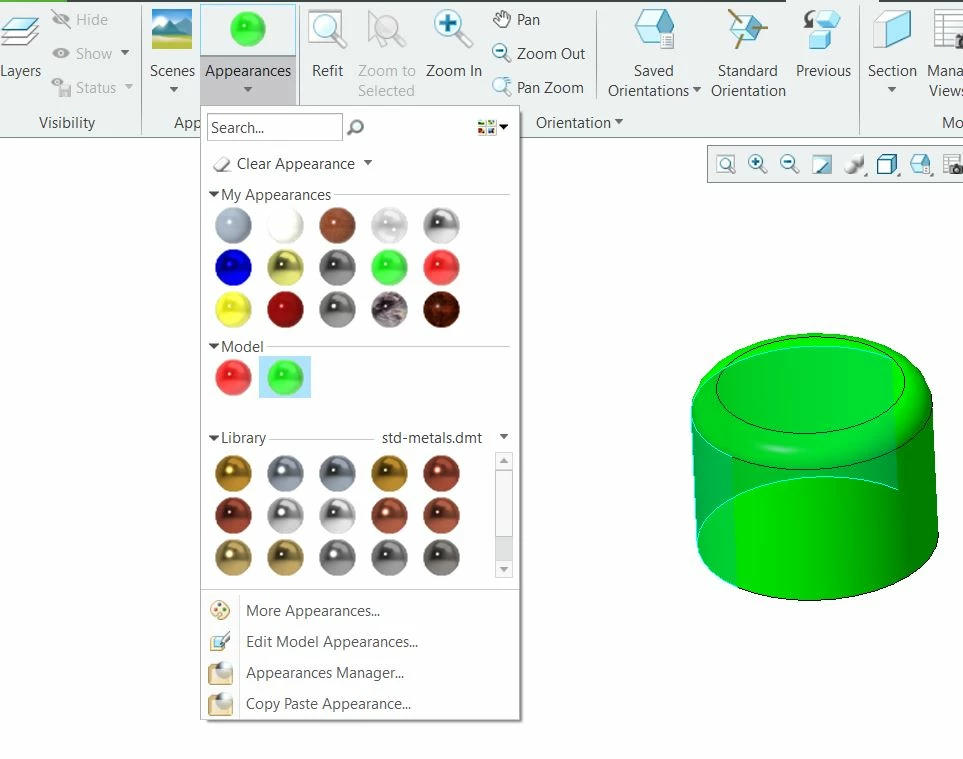

I am having a requirement to change the color/appearance of part/assembly with respect to requirement from flexibility window.
I am having only 1 model for cap as shown in image and it is having 2 part numbers differentiated by color code. 1-for Green and 1-for Red. I would like to change the colors from "Red" to "Green" or vice versa with the help of flexibility window when assembled it in its upper level assembly.

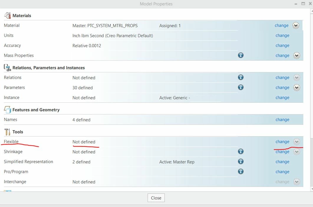

I am not sure which parameter does PTC Creo 7.0 has for appearance so that i can select that to add in CAP part, so when i am going to assemble this part in upper level assembly i can simply select color code/write in desired color code for my part to shown in that assembly.

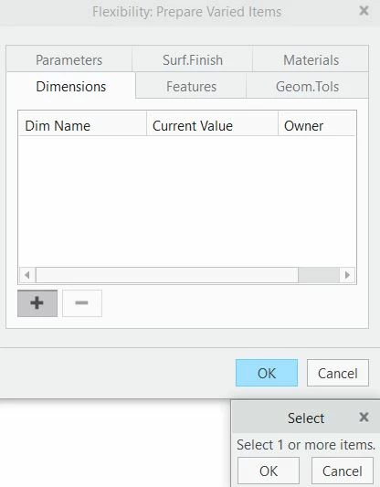

Question is- I have used this part with pattern in its upper level assembly and want to use that upper level assy with flexible option of choosing different color instance from pattern in main assy...It is not allowing me select that head part in flexible varied items....  is this also not possible in creo ? @MartinHanak
