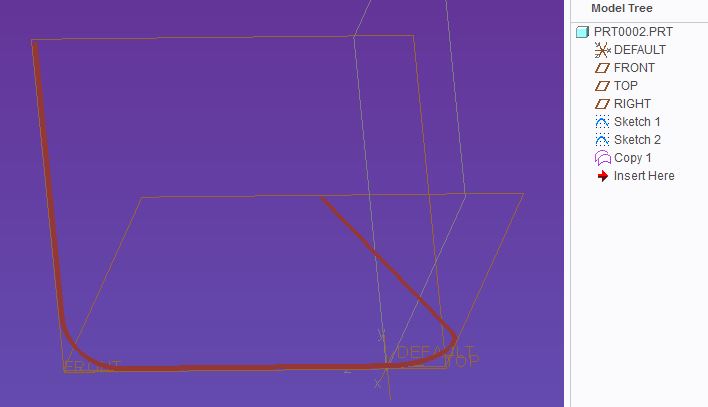

Thanks for the info. But I have a different scenario. In my assembly, there are datum points and I want a curve to pass through that with a control of radius. The curve should not be formed by default. So is there any method to control the curve radius?

There are at least a couple of ways to accomplish this if I understand what you are trying to do.
If your path can be divided into planes, one or more sketches can be created with tangent connections and full control over the radius.  The path can then be made into a single line with an approximate copy.

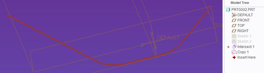

If the path is a bit more complicated, parts of all of it can be created using the intersection of two sketches.  This can make radius control a bit more difficult unless you are very careful with selecting the sketch planes and the relationship between the sketches..
