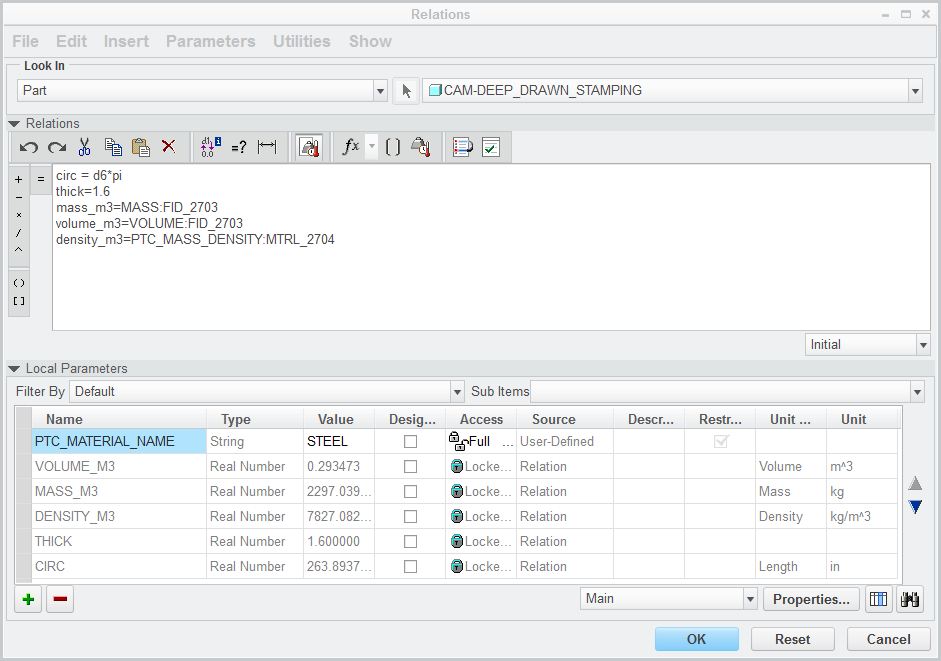

I was able to build relations for mass properties to give me other units without too much trouble.
You can calculate the Mass Properties by changing them in file>prepare>model properties>Mass Properties. Of course, it would be better if you first select a material on the same page.
Once you calculate the mass properties (click Calculate), these properties are added to your part parameter list. Now all you need to do is add parameter using the units you want. Now you have relations that can be used in whatever form of report you need.
I know... more work that one should think is required but it is there, as so many other things with PTC.
