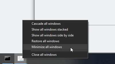

How about this:
Hold "Shift"-key then click "Right Mouse Button" on the Creo Icon (in the windows taskbar).
This will give a Menu with the option: "Minimize all windows":
This will minimize all Creo windows.
(Tested using Creo 9.0.5.0 on Windows 10.)
(Personally I always use Windows-button + M. This will minimize every window of all programs and then I go the window I need 😁.)
BH_Ooi6-ContributorAuthor
6-Contributor
Aug 19, 2023 8:22 AM UTC
Thanks. I am on Window 11 and this doesn't work unfortunately.
