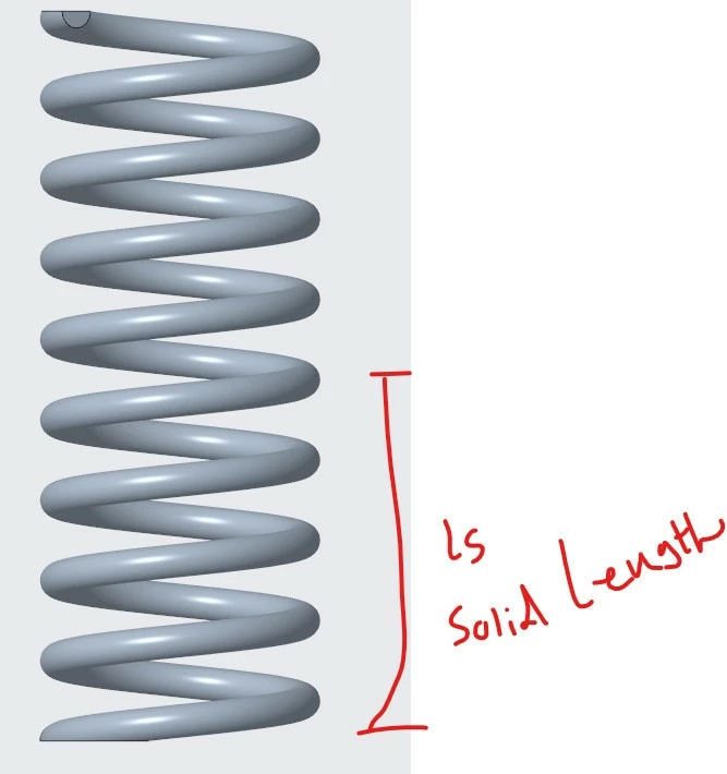

kdirth
Jan 2, 2025 4:46 PM UTC
Here is an example created in Creo 4.0.  Not saying it is the best spring example but will do what you are asking.
Relations are used to define many of the dimensions.  It is also setup with predefined flexibility so that, when you add it to an assembly, you will be prompted to use flexibility.
