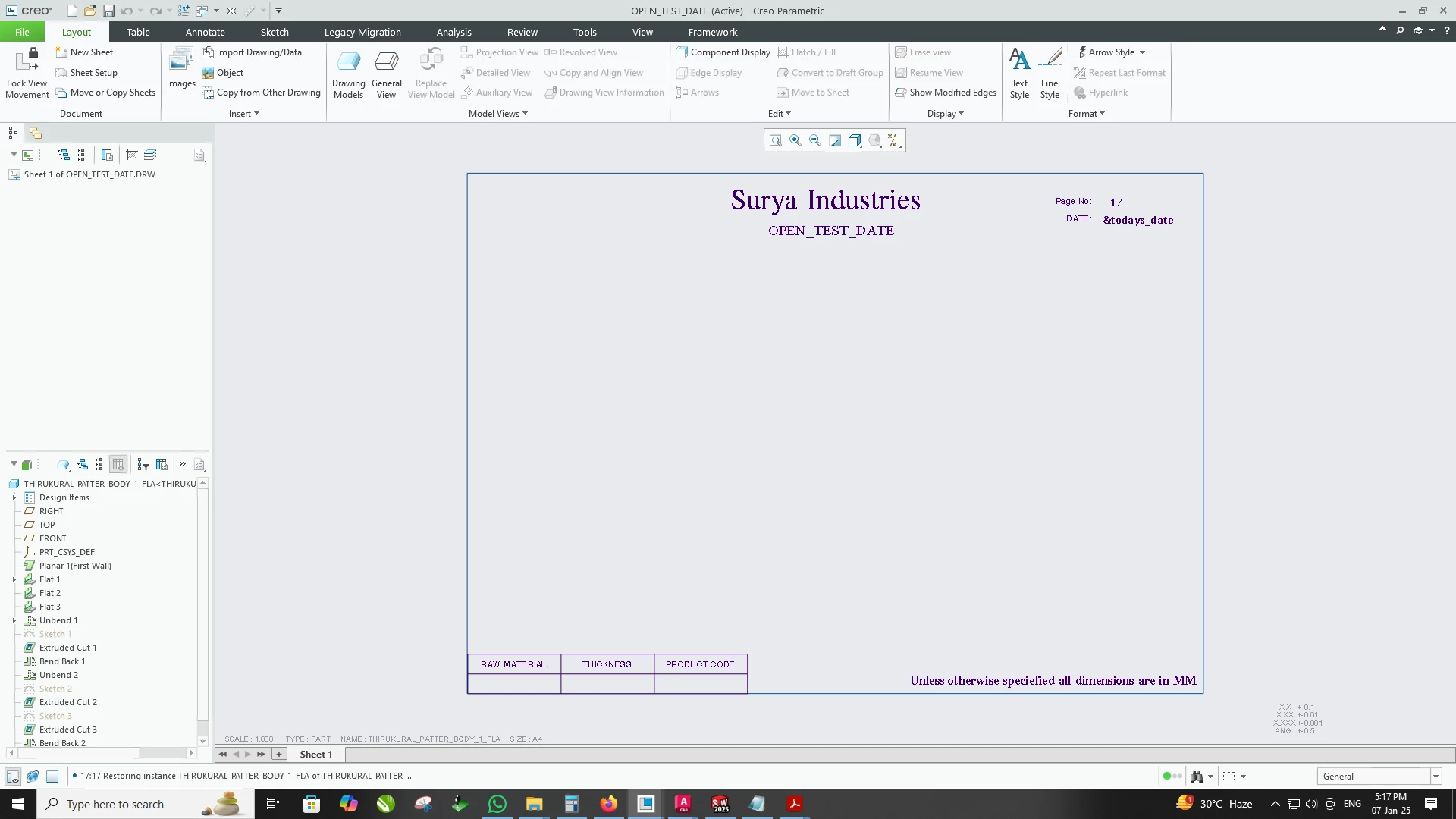

hi,
i am trying to add &todays_date in drawing sheet but the date is not showing instead of it shows only &todays_date

Edit the note and just add a space after it or just hit enter.

If you are in the format (.frm) file, it only shows the code.
If you are in a drawing, it should show the date as expected.
Jan 7, 2025 11:46 AM UTC
its same as the note not showing date
your picture is not descriptive enough.
