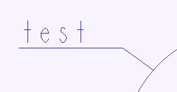

In a drawing I make a detailed views and switch the leader type (toggle leader type - above) and arrow style (to None) each time.
Please tell me if there are options in the prodetail that are responsible for these functions?

default_view_note_orientation  above_extended_elbow makes the detail view note above. above the extension
I don't see a setting for no arrow
default_leader_arrow_style  no_arrow will make note leaders without arrows
default_note_leader_type  std_iso will make notes above the leader extension
These all control creation and do not update existing.

I just tried.
default_leader_arrow_style  no-arrow
This did not update existing notes.
