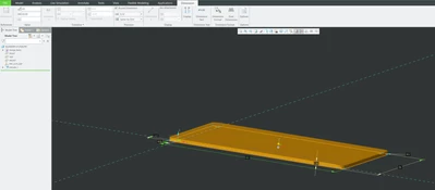

In Creo 8.0 part mode, when attempting to go into a dimension to add a tolerance, the entire tolerance section is grayed out.  Is there a setting that needs to be changed to enable it?  Did not have this issue occur in Creo 6.0.

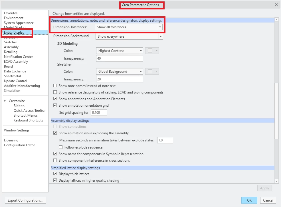

you have to set TOL_DISPLAY  YES option in config.pro file

Dec 22, 2021 3:10 AM UTC
That worked - thanks!
3-Newcomer
Jul 20, 2023 12:10 PM UTC
This does not work in Creo 9
