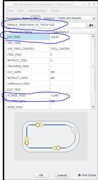

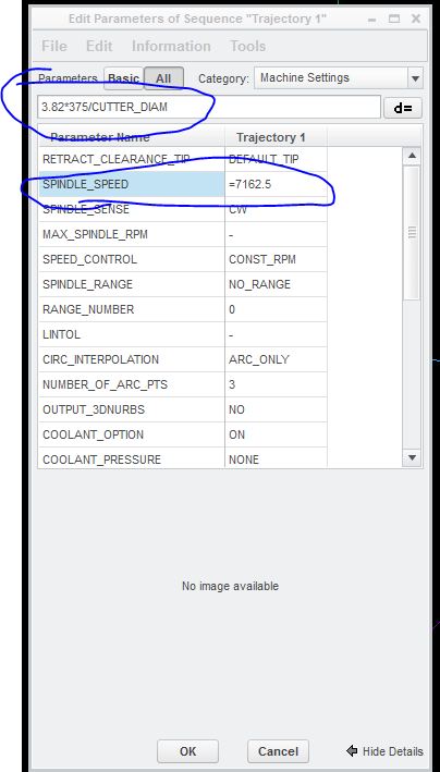

Jeff,
Have you tried creating site files for you generic milling parameters and building in equations in the machine parameters for speeds and feeds. For example I have A site file set up for the way I like to machine using trajectory I have for instance by spindle speed (sfm*3.82)/CUTTER_DIAM pro will do the math for you. Pro will automatically grab the tool diameter and also number of teeth and any other tool info and plug all the correct numbers in for the parameters. The only downfall is for machining different materials you have to change your sfm and chip per tooth. In the cut feed box I have the equation (SPINDLE_SPEED*CPT*NUMBER_FLUTES) also I have the step depth, plunge feed, step over setup on equations. This wording in the equations might not be exact because I do not have pro pulled up at the moment. But if you go to tools set-up and select tool info at the top A window will pop open with all the tool info words in the box's and those are the correct words to use for the equations. I will try to post A sample of my equations tomorrow. It sounds like a lot of work but it is real simple you basically will have your site files saved for you differnt toolpaths you can name them what ever you want and save as many as you want. Then when you create A toolpath you just open your site it fills in the parameters and that is it. As fas as your tool offset question goes if you always use the same tools on A particular work cell maybe you should just save A tool library to the work cell then the tool you want are always in the same pocket. I will post A sample of my parameters so you can try it out if you want.

Here is A screen shot of the equations I was talking about. Also as I said before you can create as many site files as needed A suggestion would be to just create folders for different materials copy and paste your site files into them and change the cutting parameters in the equations per the different materials. I think I can set up A option to put in sfm if prefered but it will take me some time to do this but for now I think this would be helpful for you.
