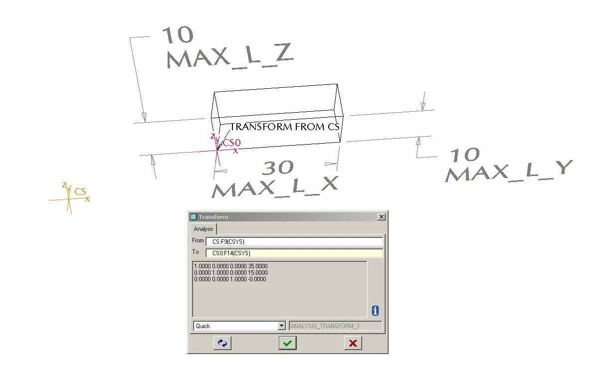

TOOLKIT APPLICATION TO GENERATE POSITION AND MAX DIMENSION BY CSYS
to automate the drawin of numerous part, has
anyone made a Creo toolkit application that can generate max dimensions for a given 3D model?
3 parameters must be generated in the 3D model
MAX_LENGTH_X
MAX_WIDTH _Y
MAX_ HEIGTH_Z
and  coordinate of max points alwais  referred by coordinate system (see example measure transform) ?
Thanks for your time, Luca.

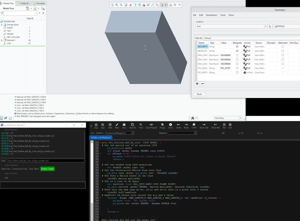

Here a screenshot
