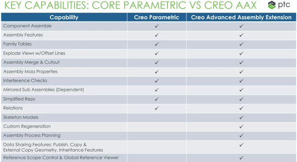

What is the difference in assembly functionality between Creo Design Essentials and Creo Design Essentials Plus? I can see that Creo Design Essentials has ASSY_PERFORMANCE module compared to Creo Design Essentials Plus has ASSEMBLY module. Existing PTC Article CS58879 has a great list of Top Down Design functionality but it is not clear which functions are available with the new Creo Design Essentials licenses.

    Well, you do need AAX to enable critical top-down design techniques, as shown in CS28079 "Merge/Inheritance, Publish Geometry, Copy Geometry and Shrinkwrap options are grayed out in Creo Parametric" or CS29037 "Unable to create skeleton model or edit definition of skeleton model features in Creo Parametric".
    Actually, I found a list in a PTC sales presentation. "Creo Parametric" is a proxy for what you get in Creo Design Essentials:
    Edit: I'd recommend you reach out to your PTC sales rep regardless.

    Well, we don't have a package called Creo Design Essentials Plus, but it goes from Creo Design Essentials to Creo Design Advanced.
    Creo Design Advanced has the Advanced Assembly Extension as part of the package. There's some top-down design things you can do without AAX, but you definitely want AAX.
    I attached our datasheet for AAX which tells you more about what you can do with it.

    My mistake! You are correct, the package name I meant to compare to is Creo Design Advanced.
    The reason for this is to provide my users with a list of functionality differences between Creo Design Essentials and Creo Design Advanced.  PTC Article CS298294 lists the module differences, but functionality difference between ASSEMBLY vs. ASSY_PERFORMANCE is not clear.
    Do you have a list of the "top-down design things you can do without AAX"?  That sounds like what we're looking for.
