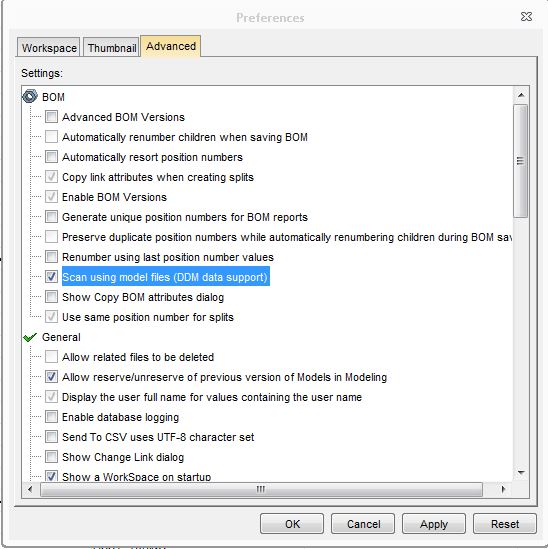

If i import for example 10 times a bolt from the modelmanager into the 3d model and i want to create a bom list to put onto the drawing the total quantity of these bolts is 0 (zero), how can i solve this so that the total quantity is right

Hello Tom,
We had contact to the cadserver helpdesk, because some of my college's had the same problem and some others not.
The solution is that in the Modelmanger in the preference tab-advanced, the Scan using model files (DDM data support) has to be clear

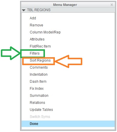

Hello Han Snoek
got an idea on my mind:
Repeat region parameters for SORT REGIONS or FILTERS are missing in your problem part.
     - check repeat region settings

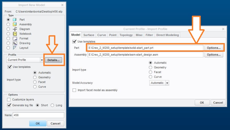

If this problem occurs only in imported parts, than try to check "import template".
Try to select different import template. For example the same model solid_start_part.
Regards
