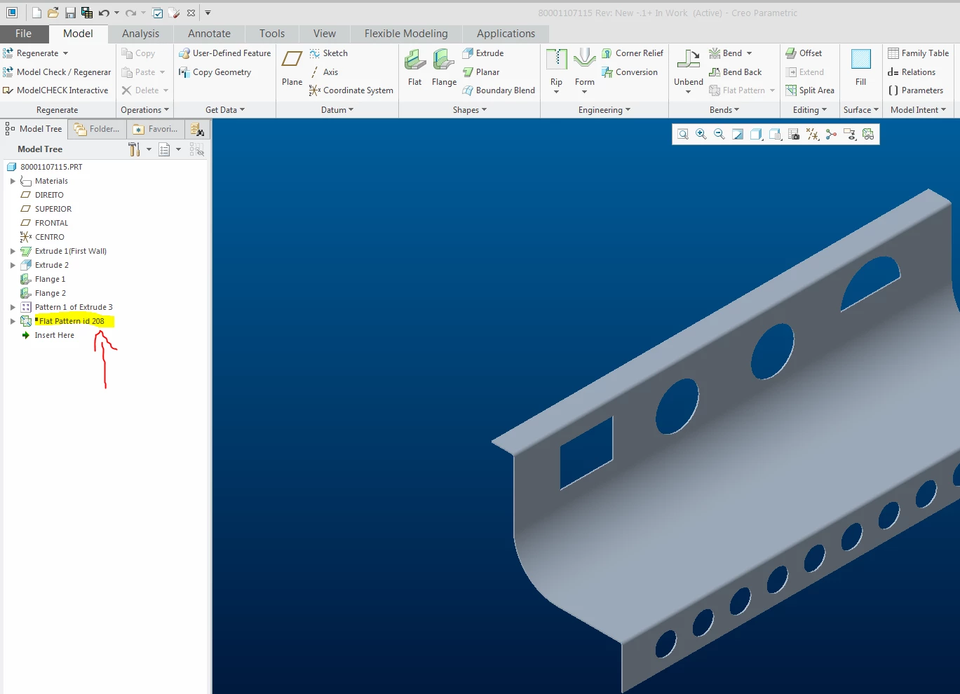

I'm trying to run a mapkey that needs the ID number that is generated when you create a Flat Pattern. When the flat pattern is created, if you take a look at the Model Tree, you'll see that the name of the Flat Pattern is "Flat Pattern id ###". Those ### are always a different number.
The mapkey I'm developing depends of that Flat Pattern ID number to run, and it's always different when you create a new part...
You can also check ID number in the Model Information. It's always the last item of the Feature List.

I'm developing a mapkey that depends on the ID number of the "Flat Pattern" to run correctly.
Every time a Flat Pattern is generated it generates a different ID code, the name of the Flat Pattern generated indicates that number, as you can see in the Model Tree (Flat Pattern id XXX), where XXX are always different numbers for each different part, for example (Flat Pattern id 154)
That id can also be checked by right clicking the Flat Pattern at the Model Tree>Information>Model Information and looking in Feature List.

Actually I've tried this.
I did a search from the find icon, accessed the Feature Information, copied the Internal Feature ID, pasted it in the right place into a .txt file that is saved in C: and wich contains the updated relations. These updated relations are pasted in the part relations.
The problem is when I do to other parts it doesn't copy the new ID, it always uses the one that was used to generate the mapkey. I don't know if is it possible for the mapkey to recognize the operation "ctrl + c" and "ctrl + v"... Have any idea?  Thanks!
