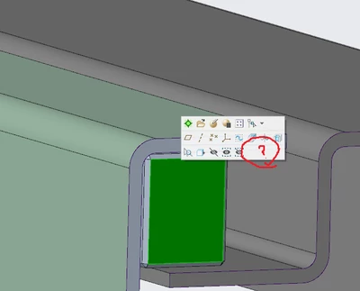

Hi
I can see and work with the transparency icon in part mode but can't do the same in assembly.
Any know what is the issue?
Even in view manager changing transparency doesn't affect anything.

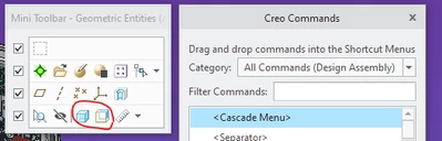

I don't see a transparent icon in part mode in 7.0.  There is a transparent and shaded icon available in assembly mode.  RMB on mini toolbar and filter for transparent or shaded to drag them onto the mini toolbar.

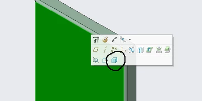

Jul 14, 2022 6:23 PM UTC
Thanks for your solution but I'm looking for a shortcut icon like the one that exists in part mode:
I saw in my colleague's software (assembly mode) that he is able to use it but I don't know why mine is not working.

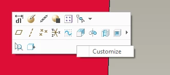

In an assembly, you should be able to RMB on that pop up menu, then select customize. You search for the appropriate function.
