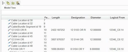

I work with CreoParametric 2.0, and more specifically with the cabling application. Downstream services (especially production lines) use CreoView in order to visualize the 3D models. The problem is that all informations that can be easily displayed in Parametric (such as length, diamater, etc) don't appear once the assembly is opened in CreoView.
Tree in Parametric (Harness with lot of tubes with different data):
Tree in Creoview (only the name of the whole harness is visible):
Is there a way to export the assembly into CreoView such that the wanted information is displayed?

Best answer by llie
You can now get cable length parameter in Creo View 4.1, but you have to be using Creo Parametric 4.0.
llie17-PeridotAnswer
January 2, 2018
