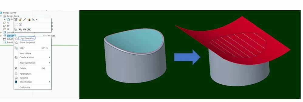

BHOoi
Oct 19, 2022 5:47 AM UTC
FYI, there is a new enhancement in Creo 8 to help what you wnated to do. The cutting surface(or quilt) can be created on need basis via the new option "Copy Snapshot":
