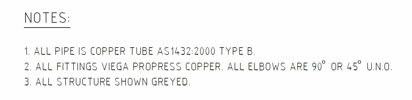

February 15, 2012
We use SWisop3.ttf works in PDF's as well see sample attached
