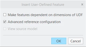

I cannot seem to modify the udf, and add in drill tip angle into my family table.

You only posted the .gph file and not the part(s) used to define the UDF. I do not think that Creo will open a .gph without some other files associated with it. Inclusion of the angle dimension in the UDF depends on how it was originally created.

Depending on whether the UDFs were created as standalone or subordinate is relevant. Does you company have a UDF library? In order to modify the UDF you will need access to the source files that define the UDF not just the .gph file. You will need to investigate how they were created originally.
When I place the UDF defined from your .gph file the source model option is greyed out. The source model is where you would want to change the drill angle. I am not sure you are going to be able to modify this without the source file. You may have to recreate the UDFs to get what you want.
