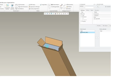

Dale_Rosema
Feb 17, 2022 3:38 PM UTC
With the help of @StephenW , the suggestion was to use the find tool, component selected, and search for 1027_4001.prt.
I did this in the generic. Used the >> to move it to the right box. Selected it in the right box and clicked on "Remove".
Saved the generic. Exited, cleared memory, modified the name of the model (added zz in front) to zz1027_4000.prt.
Re-opened the generic, and the model lived "happily ever after"....
THANKS STEPHEN!!!!

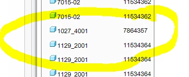

Dale_Rosema
Feb 4, 2022 3:11 PM UTC
From the model info:
and this

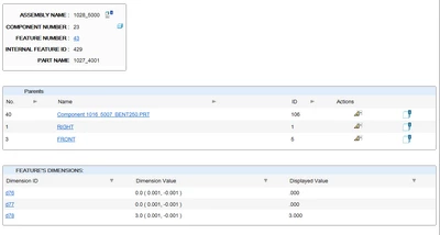

Dale_Rosema
Feb 4, 2022 3:20 PM UTC
Somehow I generated a .inf file for the parent assembly. In it is the following for the "missing part".
FEATURE NUMBER 49
INTERNAL FEATURE ID 565
PARENTS = 3(#2)
TYPE = PATTERN
LEADER OF A (4 X 1) DIM VARYING PATTERN
MAIN PATTERN DIMENSIONS:
d86 = (Displayed:) .000
( Stored:) 0.0 ( 0.001, -0.001 )
d87 = (Displayed:) .000
d88 = (Displayed:) .000
d92 = (Displayed:) .000
( Stored:) 0.0001 ( 0.001, -0.001 )
d93 = (Displayed:) 2.906
( Stored:) 2.906 ( 0.001, -0.001 )
tbraxton
Feb 4, 2022 4:57 PM UTC
The reference viewer should show the reference path for the missing part. If you are not able to delete this child reference in the assembly then you can try to "fool" Creo to get rid of it. If you are unable to delete the reference post back and I can suggest how to try a fix to get rid of the reference.
You will need to create a dummy component with the name of this missing part and reestablish the link in the assembly. Once you do that you may be able to delete the component resolving this unwanted reference. it may be more complicated depending on the nature of the parent/child refs.

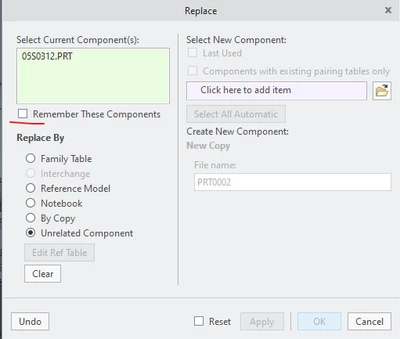

kdirth
Feb 4, 2022 4:16 PM UTC
I expect that you had the Remember These Components checked in the replace dialog box.
I would suggest looking for it in the assembly using reference viewer.  Hopefully it is there with a trash can on the link for you to select.
StephenW
Feb 4, 2022 4:28 PM UTC
The source of endless number of unexpected references since I use replace regularly.
Set the config.pro option:
remember_replaced_components NO
to automatically un-check the box, my preference since it is rare to be changing back and forth.
Dale_Rosema
Feb 4, 2022 4:41 PM UTC
I think I have that config options set already because on another change I recently made with an unrelated component, the box was unchecked.
