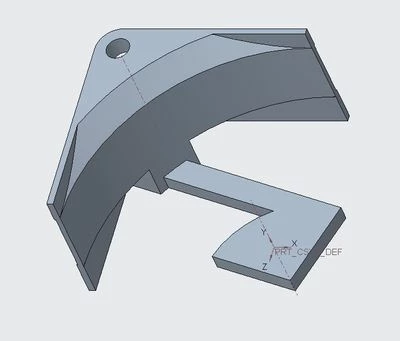

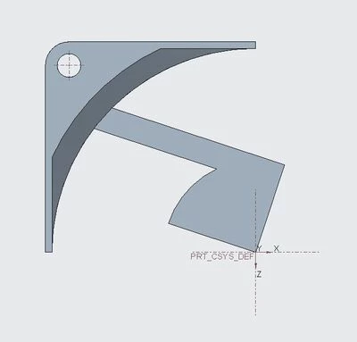

I am Having problem when trying to pattern this 1/4 part around Y axis. In SW I would simply use combine option and then making pattern around Y axis with 4 parts at 90 degree option. It really is an elementary thing but it seems I am stuck on this one. Is there a way to do this similarly in Creo?
Pattern option seems to be dimmed if nothing is selected. Can I somehow select all the features in the model tree with pattern option being enabled? I tried to pattern one feature at a time but I get errors in the model tree. Then again I doubt that this is the right way to do it.

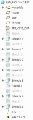

Couple of things.
Group your features...select them all, right click, group
Your axis (probably a_5), needs to be before the group in the model tree.
Use the "axis" option in pattern.

Tilen1-VisitorAuthor
November 10, 2017

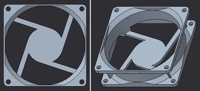

After fiddling around I managed to pattern all the features.
Thanks again.
