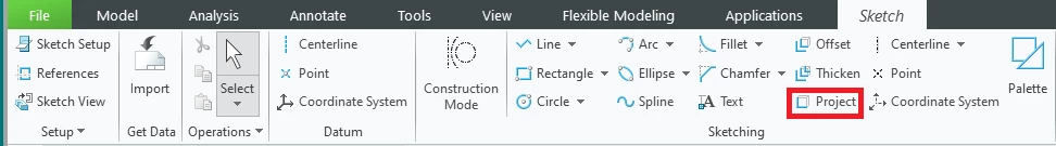

Aug 24, 2023 7:49 AM UTC
in Sketcher mode use Project command.
