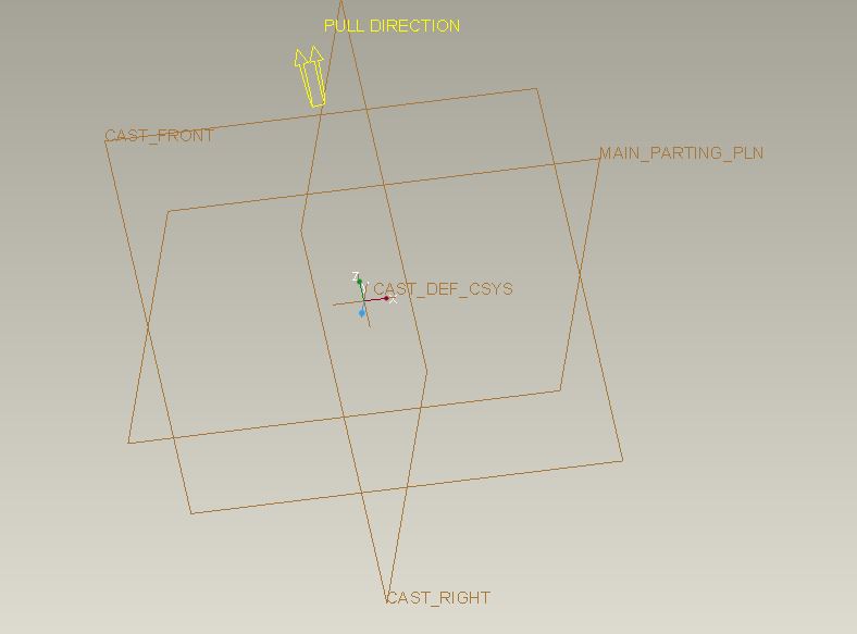

I have modified datums and views for my part and assembly template to use the World Coordinate System.
This was a lot of work.
Last week I discovered that I should have modified a template for MFG_CAST.
On 1st look it appears that it is set up correctly as the CSYS is oriented correctly to our top view and the pull direction.
When this exports out it gets turned around 90 degrees to what it should be.
The only indicator that shows what is actually happening is that the Red, Blue, Green arrows point away from the CSYS.
Would I just need to rotate all the datums, CSYS, views and pull direction to fix this?

It's getting harder and harder to fight the built-in hidden coordinate system. Annotation planes are now based on this internal hidden coordinate system, NOT the named views (like they claim). If you add a default coordinate system to the model, it will always align itself with the built-in hidden one. This will show you how the model will be exported (assuming you don't select an alternate coordinate system to export on).
To answer your question, you simply rename the planes and the views to have them make sense when the Z default coordinate system Z is pointing up (and X to the right). Done correctly, you should be looking at the "back" of the front plane since positive Y is away from you.
If you haven't already done so, I'd suggest you change the following config.pro options.
orientation user_default
x_angle -38.43
y_angle -22.91
These will force Creo to roll the model around to Z-up orientation when selecting "default orientation".

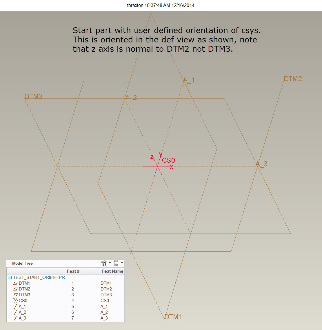

December 16, 2014
This may help resolve the issue for users that have never built start files from empty files. This part sets the csys arbitrarily and can be modified by the user as desired. I suspect that part of the issue is the fact that start files contain datums that imply orientation of a part resulting in a front datum plane and defined view that is not consistent with user expectations. This is why I am still of the opinion that the default datums of start parts should not in general imply orientation in the absence of geometry. There are conceivable exceptions, however start model default datums should not have names like front, top, right IMO.
This approach to start model Csys orientation plus on the fly assignment of views relative to a user defined "front" orientation of the model should go a long way to clearing much of this issue up. You can change the orientation of the Csys as required/desired. Pair this with automated view saving based on a user defined "front" view and you can deal with orientation on the fly at any time in seconds. Creo 2 example start file enclosed.
