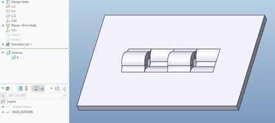

To make this shape in sheet metal, this is possible to create it in one feature? To create a UDF and a tooling to be use in sheet metal manufacturing. I want to be able to use 1 UDF, Because the punch make it in one stroke. I understand what I have done, but if someone have to create another part when I not at the office, it may be a bit confuse with the two UDF.

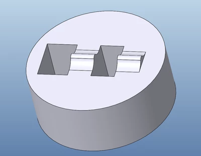

At first, I have created this, hoping that it will form the two side in the same time. But it was forming only what was passing through.

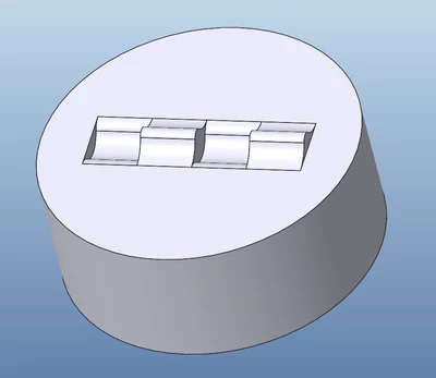

To create the other side, I have to create a family table of my first form to make some hole where the initial form will be in my sheet.
