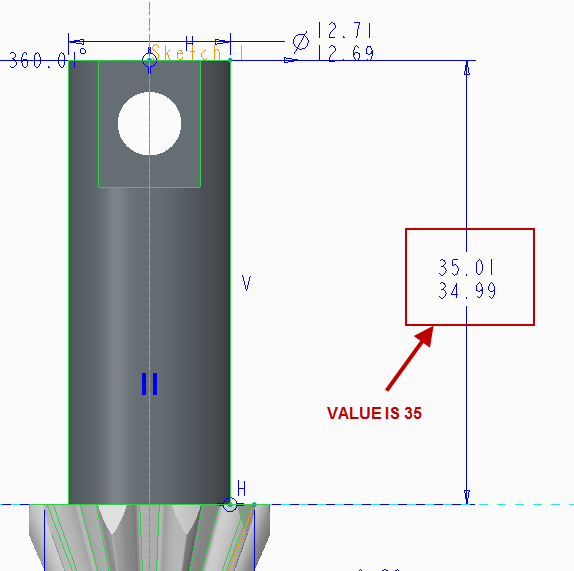

Creo 2.0.....I select a feature on a model, right-click and select the Edit option. I get two dimensions, which actually frame the current value I am trying to change. Example; a 35.00 dimension displays as 35.01 and 34.99 below it. And when I change one/both, the feature does not update.
This feels like a setting, but as an intermittent user, these are the things that trip me up.

You need to click on the dimension properties and set the dimension display back to nominal from limits. Then you can change the value. I get frustrated by this a lot on older designs.
March 2, 2016
Thanks Ben. That did the trick.

If you upgraded from an older version of Croe/WF, the dimensions were defaulted to Limits. You need to go in and change them to Nominal.
