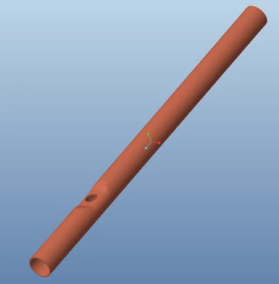

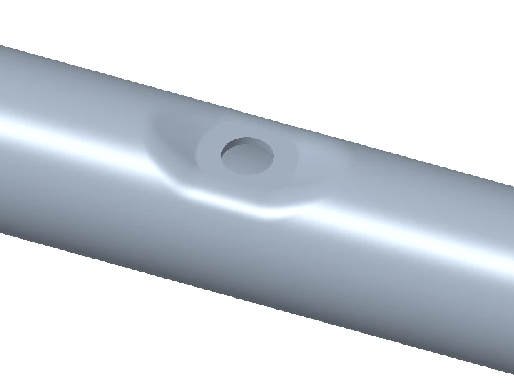

Looking for input on how to make a flat feature as a udf. Accomplished (pictures) in solid and shelled but would like a UDF to use within piping.
Is this type feature capable of being a UDF in piping?

We solved issue by creating a UDF and using it in the part (pipe solid) which is created in Piping.
