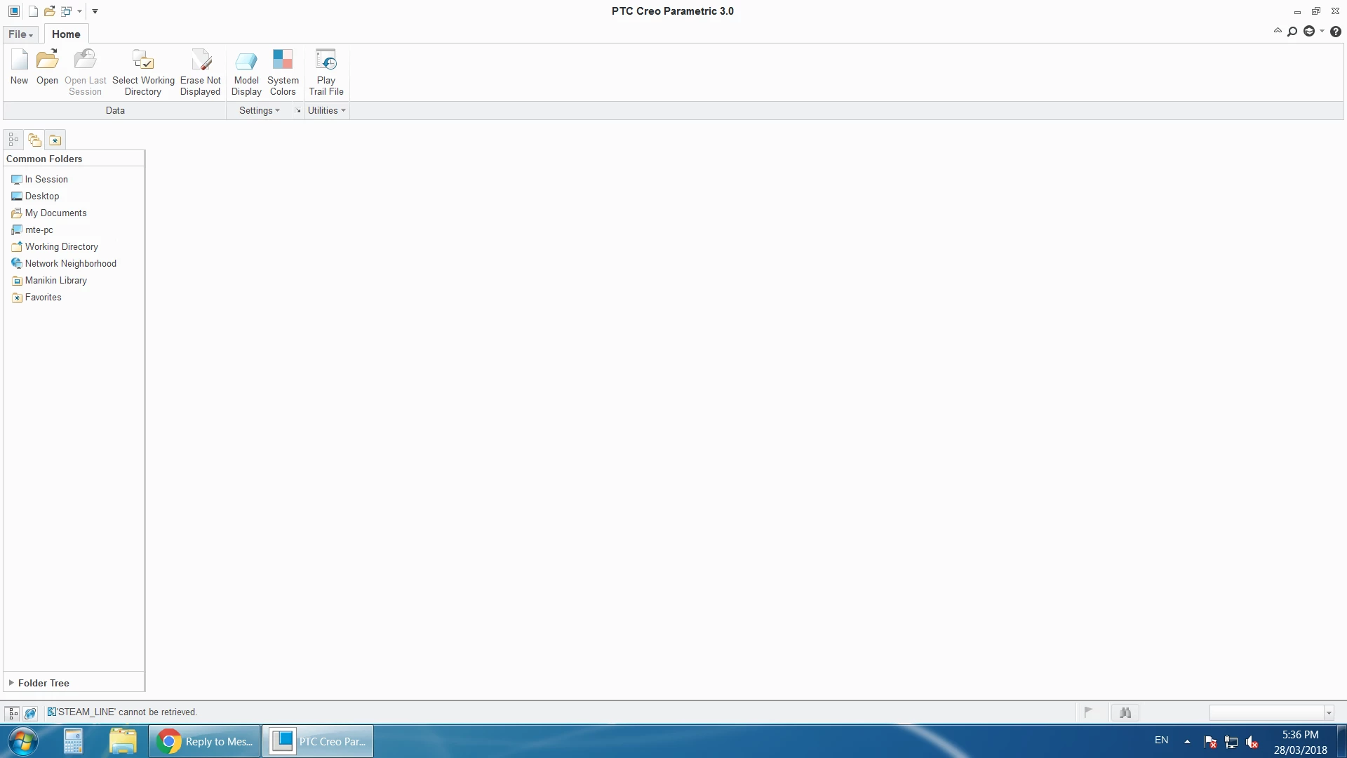

    Hello everyone.
    i have a problem about opening issue. and i think it related with this post.
    i have creo 2.0 student edition. when i try to open part or asm i am responed that : "asm0001 cannot be retrieved." (asm0001 is name of flie.)
    i read a lot of forms or post. there are similar solution on it. bu i didn't solve this problem.
    i'll follow this link.
    thanks
    2-Explorer
    Feb 11, 2016 4:02 PM UTC
    Sometimes the really interesting error messgaes scroll up one or two lines. Maybe expanding the message line(s) a little does provide more information.
    Mar 28, 2018 12:08 PM UTC
    .asm can not be retrived
