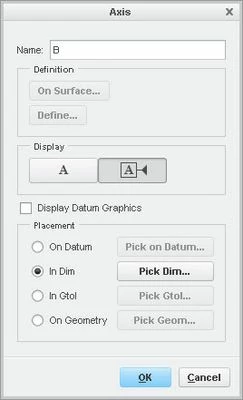

Yes i logged a support case. I haven't heard anything useful back so far from PTC. I don't understand why they would have removed this feature. All im trying to do is attach a datum flag to a diametral dimension or an existing geometric tolerance. I must be missing something basic....

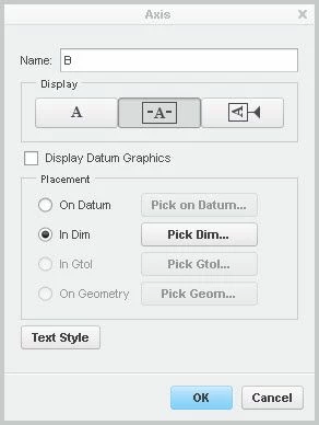

I haven't taken the opportunity to get on 4.0, here's the screen shot of creo 3 datum in the draiwng and in the model. What does the creo 4 - right click properties look like in the drawing and in the model?

This what the datum properties menu in drawing mode in creo 4 looks like:

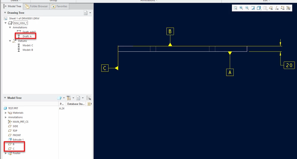

I have updated to using CREO 4.0 M060 and now you can create the datums in the model also and bring them to the drawing. Datum A was created in the drawing and doesn't have a feature in the model. Datum B and C were created in the model and bring them on the drawing view. In the drawing tree, you see the datums are in different "groups", the one created in the drawing is seen as a draft and shown in the Annotations group and the ones from the model are in Datums group.
Oct 22, 2018 1:08 PM UTC
Set the config.pro option default_gtol_owned_by_model to yes
Chris3
Oct 22, 2018 1:30 PM UTC
