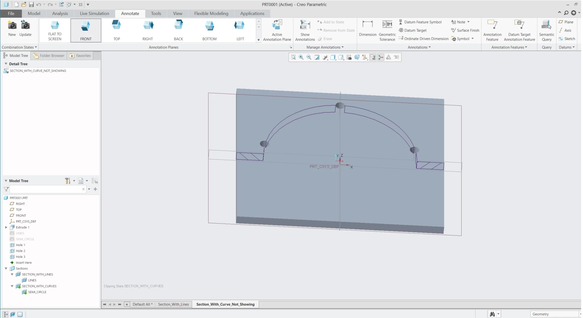

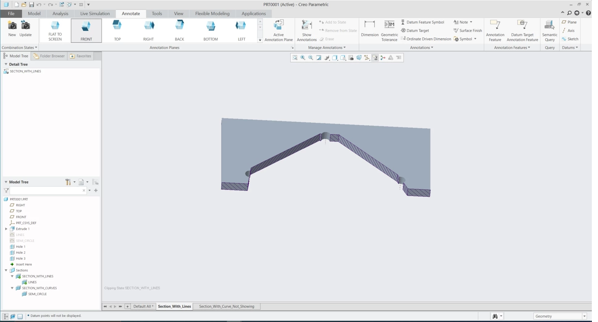

Hi Martin, kdirth,
Please find attached pictures and the part of what I am referring to.  I am trying to do a sectional cut.
View-> Section ->  Offset Section, from there I can choose a sketch. But it seems that the offset Section cannot display sectional cut from sketch that contains curve.
I know Catia can do that, and by extension Solidworks as well. I'm pretty sure Creo can do it, can it?
Thank you
Sandy

unfortunately requested functionality is not implemented. Please read  https://www.ptc.com/en/support/article/CS252750 document. It contains following text:

Looking at the messages while trying to create the section in 4.0 I get the following message:
"Offset sections that include arcs or splines cannot be displayed as clipped in shaded mode."
You can use arcs and splines to create an offset section.  However, for whatever reason, you can not show the section in a shaded mode.  Works fine in wireframe.
