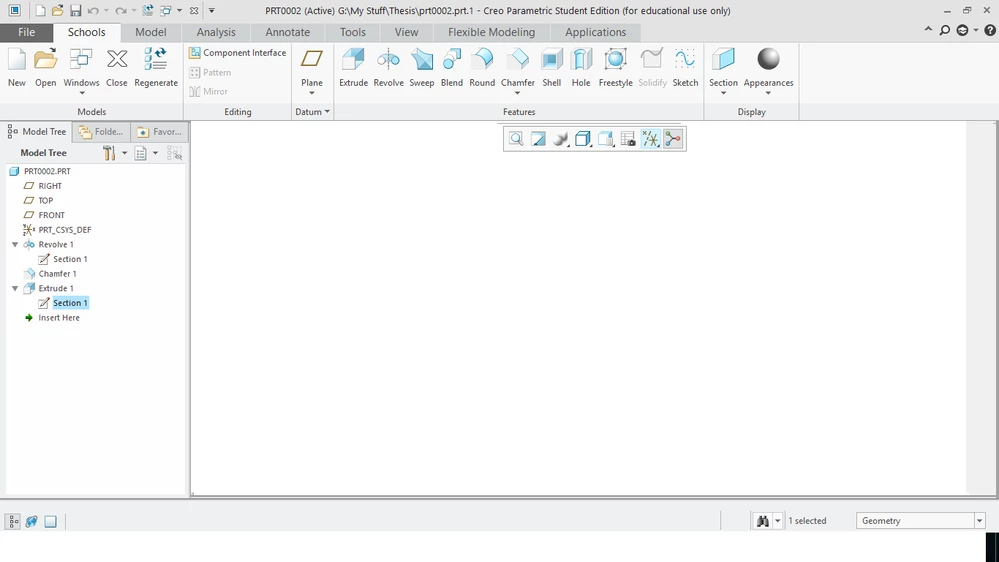

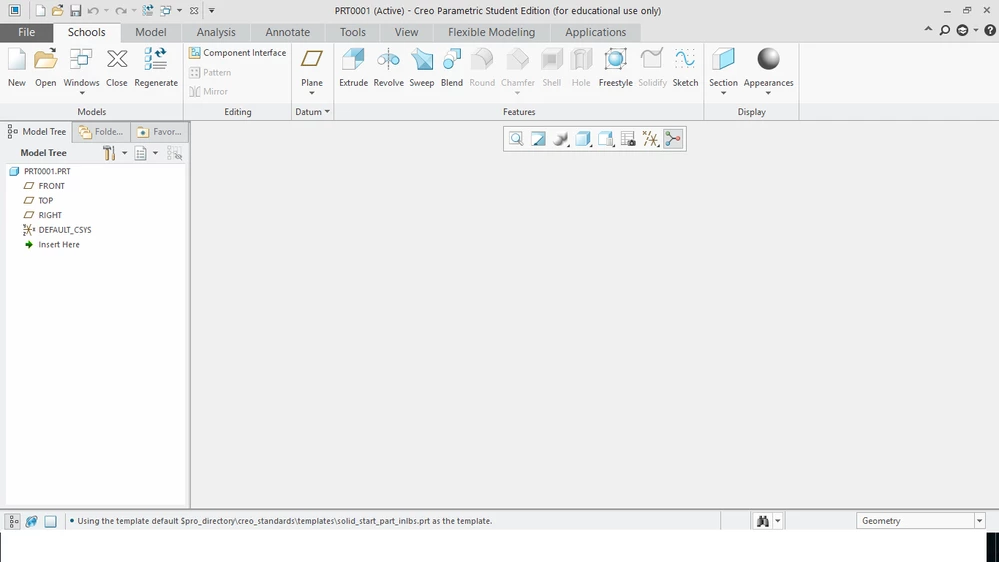

Hello Everyone,
I am unable to draw any drawings in the main window and also I could not able to open the existing drawings.
When I open the new doc/page, it's completely blank. I could not able to see any coordinates.
I have changed view settings to unhide. But the same problem persists.
if I open any drawing, I can see every feature that what I have used but no drawing.
You can see in the screenshot.

no solid geometry is displayed in opened prt0002 part. The possible reason of this problem could be graphic drivers.
1.] put following option into config.pro file and test Creo
graphics  win32_gdi
2.] update graphic card drivers, if it is possible.

Hi Martin,
Thanks for your suggestion.
I have reinstalled the graphics driver. It is working fine.
Thanks and Regards
Rohith
November 21, 2017
Just forget to inform you that setting graphics  win32_gdi option is temporary solution. It is necessary to remove the option, if updating graphic drivers resolves the problem.
