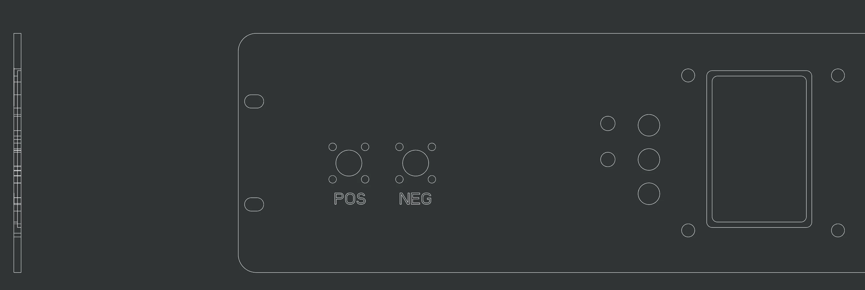

I've built a pretty simple front panel and I'm trying to make a drawing out of it.
When I placed the Front and Right view I noticed that it's showing me all the hidden lines, even though my Display mode is Shaded with Edges (I've triple checked this and I have also tried to change it to No Hidden, no luck).
View Display for each view are set to Follow Environment and all Layer elements are hidden. I've even tried to manually hide them via Edge Display and that doesn't work either (doesn't hide anything, but Show Modified Edges does highlight my targeted lines).
Lastly Force_wireframe_in_drawings is set to off,
I've looked around for previous topics and found no resolution, so here we are.

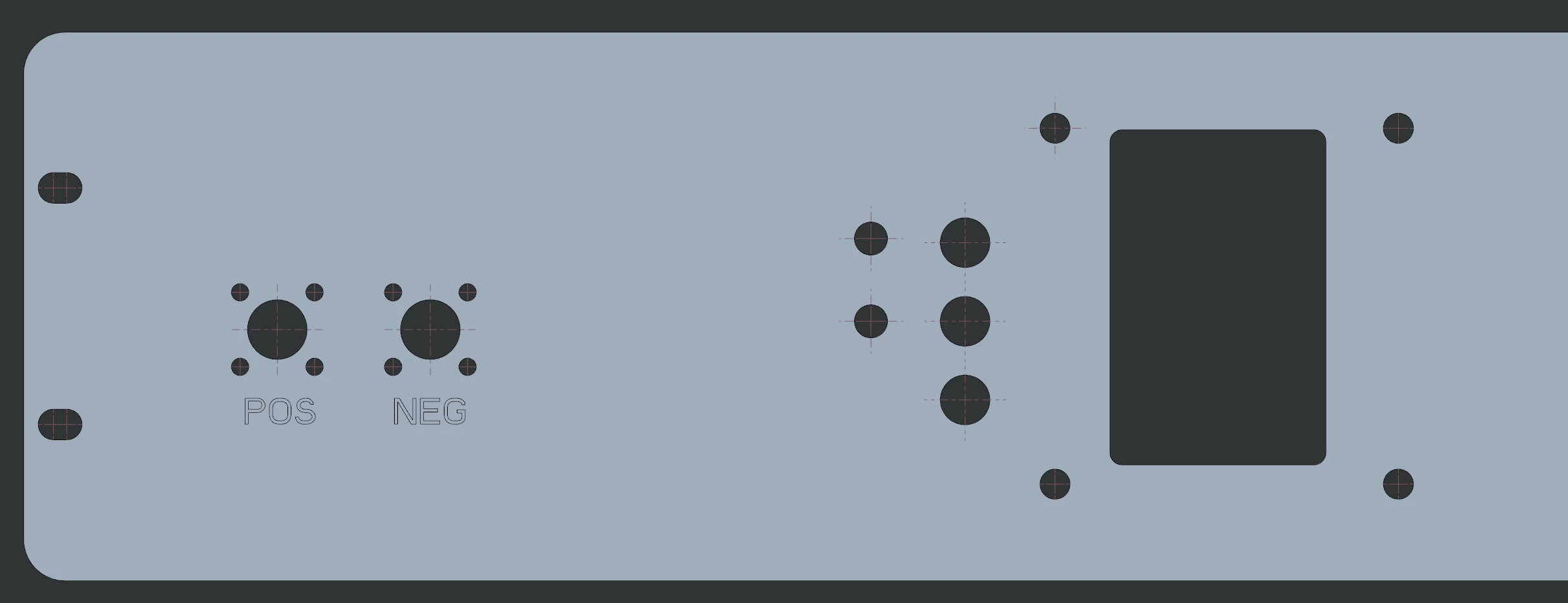

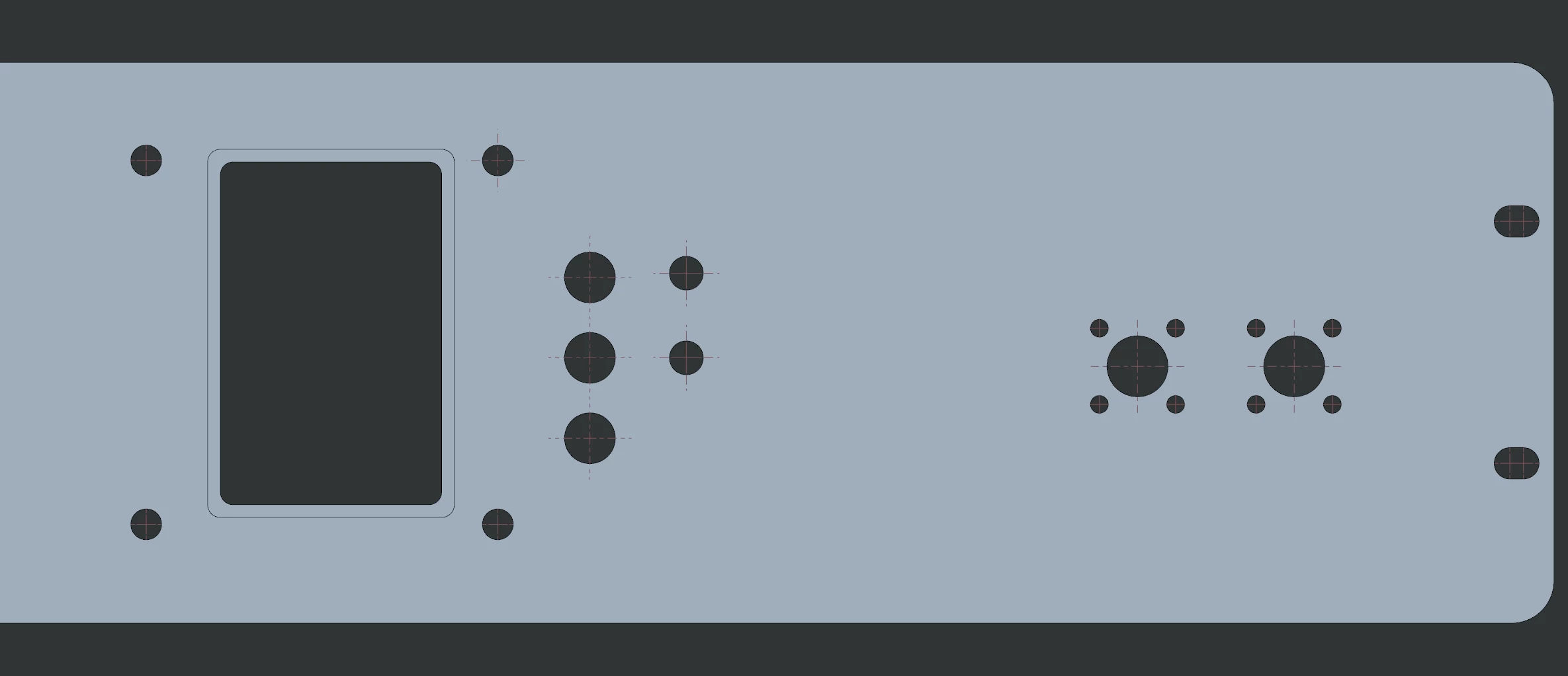

I've attached an image of the drawing (front view and right view as Section) and the 3D model from the front and back view so you can see where the issue is appearing: the rear-of-panel-cut out is showing up in the front view and the side view is showing every cut through the panel.

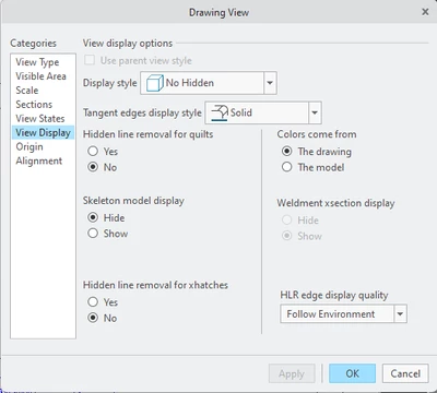

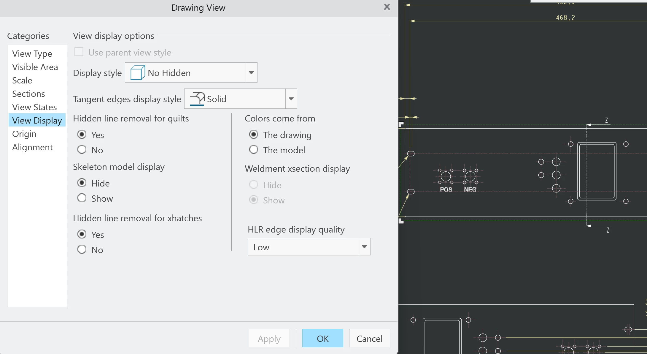

Hello kdirth,
As per my initial post, I have played with modifying View Display. I've tried to modify it both in the quick access bar above the drawing itself as well as in the View Display tab of the Drawing Views (moving from Follow Environment to both Shaded with Edges and No Hidden, neither worked after pressing apply). I've added an image of applied No Display, in Drawing Views in case of verification needed, and I also exited that menu and regenerated in case that would change something — it did not.
