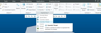

I am unable to open the user interface of cosmetic thread. Whenever I click on the cosmetic thread tab

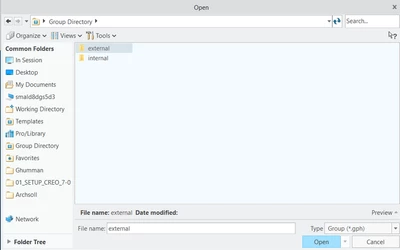

it takes me to some intudfs folder having two folders inside (External and Internal) containing .gph files.
I'm not sure if it is some kind of bug or do I have to modify some parameter in config.
Any help would be greatly appreciated.
