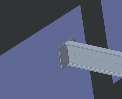

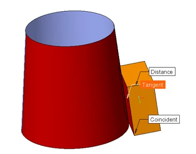

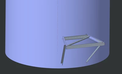

You can attach it to a round wall with a tangent constraint.  Constraining it to a round surface can be a bit tricky because Creo does not know which side of the surface to attach to.  I found it easier to define the vertical and horizontal constraints first.
