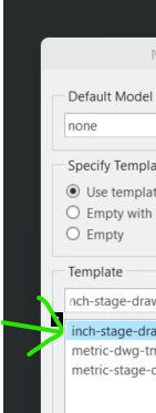

I am after some advice please. I am fairly new to using creo (have used solidworks, inventor and rhino in a previous role), I am trying to remove a template from the list on creating a new drawing. I have navigated to the folder where the templates are saved and this particular template isnt in there to remove, yet it is showing in the list as a n option. Any idea where it would be or why it is still showing?

please check setting of following config.pro options:
start_model_dir
template_drawing
See also https://support.ptc.com/help/windchill/cloud/r12.0.2.0/en/index.html#page/Windchill_Help_Center/ProEWCIntegAHProEConfigOp.html page.
