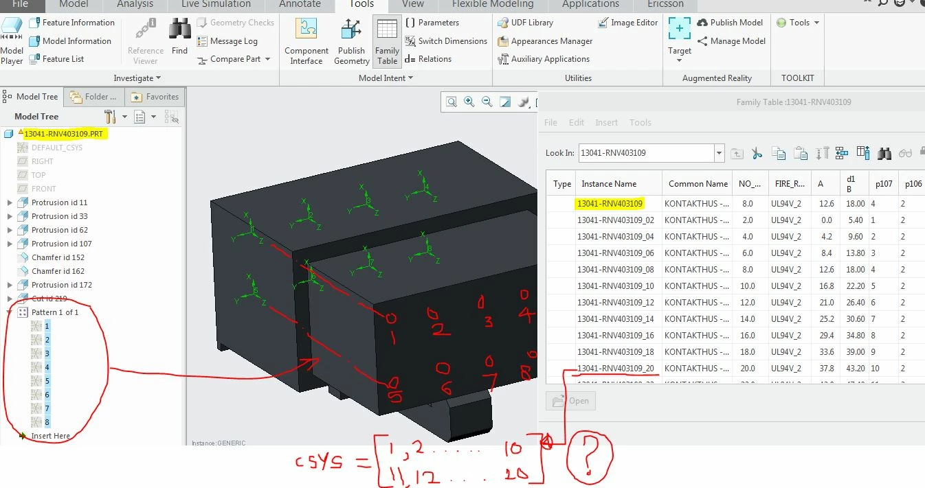

I can able to create the Family table for a Connector(Generic & Instances). But I am unable to rename the CSYS of instances ?
(Enclosed image for REF.)

Generic pattern has CSYS of 1,2,3,4 in first row & 5,6,7,8 in next row. Our required pattern for "2 pin_instance" would be 1 in First row & 2 in Second row. But achieved is 1 in First row & 5 in Second row due to carry forwarded from Generic.Also unable to rename the instance from 5 to 2. (Eg. Required pattern for "4 pin_instance" is 1,2 in row1 & 3, 4 in row2. But achieved is 1,2 in row1 & 5, 6 from row2)
My question is, how to remove the dependency on Instance from Generic to get the required pattern.

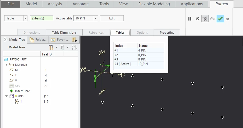

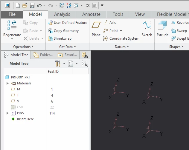

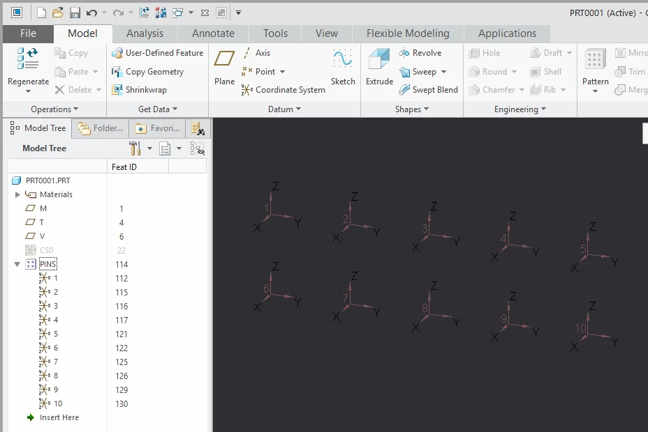

If I understand you correctly, you can achieve this with a Table Pattern.
Here's the 10-pin:
And here's the 4 pin:
