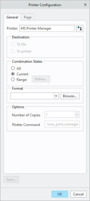

The option to save my printer configurations is not available. How can I enable this option?
See picture:
Best answer by MartinHanak
See picture:
unfortunatelly I do not have 5.0.1.0 installed.

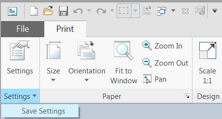

In 5.0.4.0 in Drawing mode I click File > Print and then Settings > Save Settings

please provide info about Creo version you use.
BWS10-MarbleAuthor
September 6, 2019
Version: 5.0.1.0
September 6, 2019
See picture:
BWS10-MarbleAuthor
September 6, 2019
Thanks alot!
