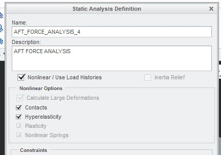

I have a mount sub assembly (just 3 components) in which I'm able to run a Hyperelasticity analysis with out any issues.
This assembly contains one part with Hyperelastic material properties and 2 parts with non-Hyperelastic properties. The assembly also includes the following bonded, contact constraints and ground springs.

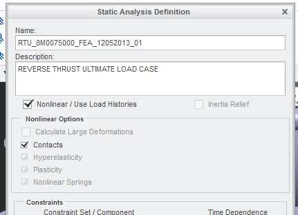

When trying to set-up a Static analysis on a higher level assembly with the same mount sub assembly included, I'm not allowed to select Hperelasticity in the Static Analysis Definition dialog box. This level of the assembly includes additional components, mechanica Fastener definitions, ground springs, multiple force definitons and displacement constraints, and additonal non Hyperelastic materials and some surface regions.
So my question is What would prevent you from selecting Hyperelasticity in the Static Analysis dialog box?
