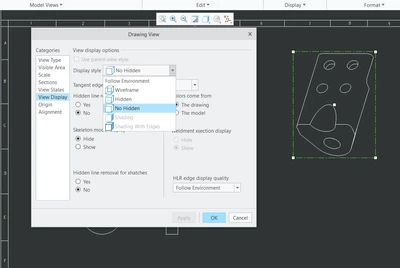

Unable to select shading from 2D drawing - display style
Hi
I am following the tutorial steps and I am trying to select the shading from display style for 2D. However, the system does not allow me to select it. Is t

Sep 20, 2023 6:02 PM UTC
Can you select it in the model itself?
Sep 20, 2023 10:44 PM UTC
I am not sure. I can select it from the mini tool bar on the top of the drawing window

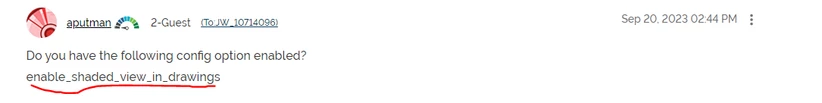

Sep 20, 2023 6:44 PM UTC
Do you have the following config option enabled?
enable_shaded_view_in_drawings
Sep 20, 2023 10:41 PM UTC
yes. This is enabled
Sep 21, 2023 11:56 AM UTC
Hi @JW_10714096
I think below is the only option to enable disable shaded views in drawing.
Please check again in your config file. Set above config to Yes.
Jignesh.

I selected different models. All of them had the same issue.
Sep 21, 2023 6:30 AM UTC
@JW_10714096 wrote:
Hi
please do following test:
  • create new General View in drawing
  • click View Display option in left pane
  • set Display style to Shading
Notes:
  • General View enables you to set Display style to Shading
  • some other view types does not enable you Display style to Shading ... what view type do you use?
