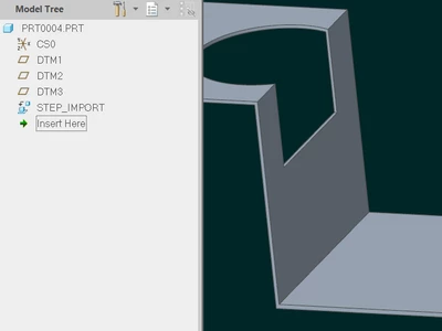

hello
I need some steps for unbend a part model and create flattpattern for this.
i try to reconstruct radius but i'dont know if is the right way to unbend because the part dont convert to sheetmetal
How can i identify radius without same thiskness features of the part ?
Please some advices
Thank you for support

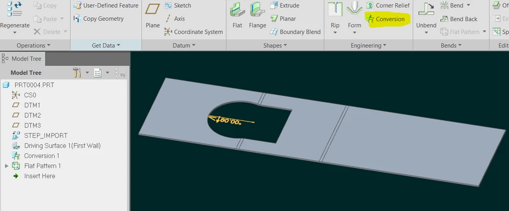

Actually, if the STEP geometry of uniform thickness, then it should be possible to switch to sheetmetal mode, establish the driving surface and then use the conversion feature to reconstruct the bends, rips and reliefs, and then also the flat-pattern:
Feb 16, 2021 4:49 AM UTC

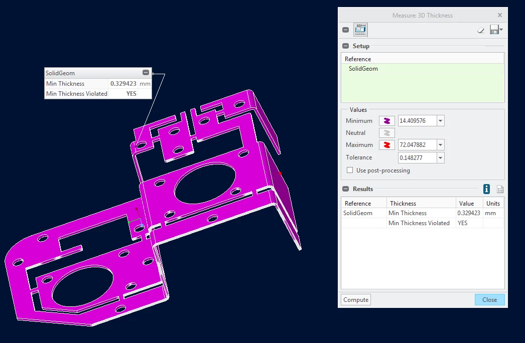

This conversion is possible, though I needed to do some preparation before the sheetmetal conversion.

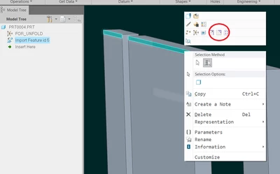

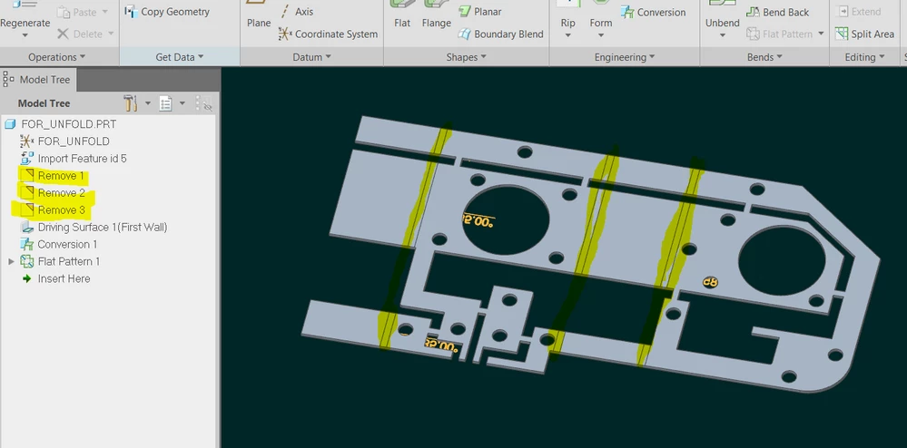

Namely, there are 3 places where the wall thickness needs to be restored to the uniform thickness:
I've done this by deleting the chamfer faces with the remove tool:
