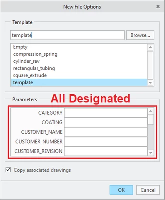

Parameters that are designated will automatically appear in the parameters list when creating a new object from that model.

Not tested but I don’t believe that the parameter popup is driven by designate.
