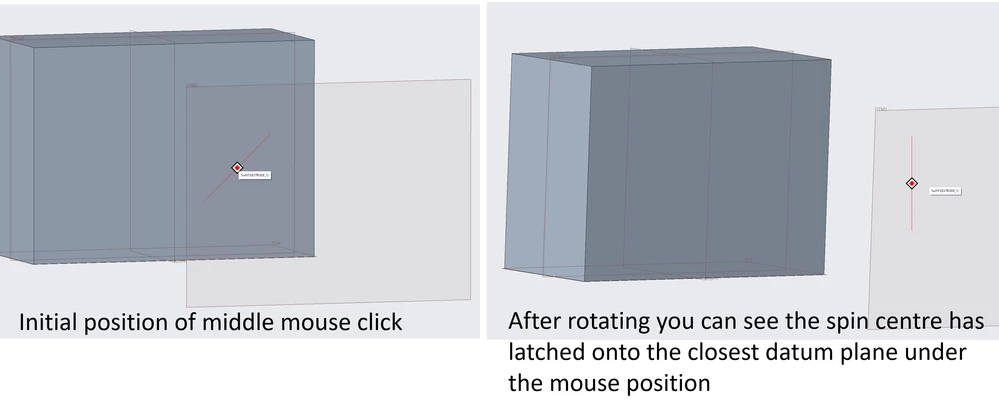

I am using Creo Parametric 8.0 8.0.0.0
Actually Using Creo 8.0.1.0 - Normally, when spinning a model the spin centre latches to a face/edge/etc.. of the model under the current cursor position.

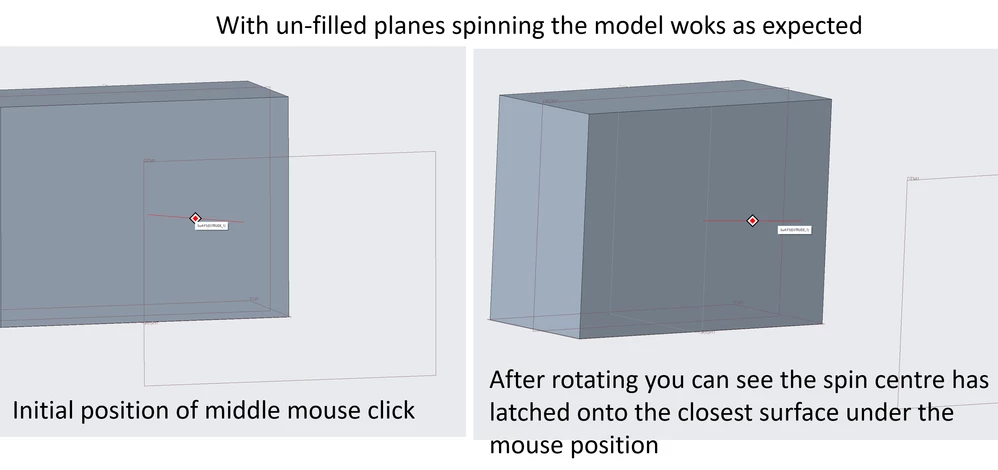

I've noticed that when the new 'filled plane display' is switched on and there is a plane in front of the model, the spin centre latches onto the plane instead on the model - even if the model edge/surface/etc. itself is highlighted.
Switching the filled plane display off stops this happening.
Is this intentional?
Is it possible to stop this with some configuration option.

    This is a test model - a simple block with a datum plane offset in front of it.
    With Filled Planes:
    With filled planes spinning the model becomes more difficult.
    I noticed this when working on a small simplified rep of an assembly where the parts I was working on were behind the main datum plane – of course the work around is easy – switch off the filled planes – but I quite like them so am just looking for a way to stop this happening.
    Not sure if it was intended like this or just an oversight…
    Aug 16, 2021 11:19 AM UTC
    Hi @pwalton,
    Thanks for the images and this really helped me to reproduce the issue.
    I think this is working as designed. When the datum plane is not filled, the cursor sticks to the highlighted surface and when datum plane is filled, the cursor sticks to the filled datum plane and not on to the highlighted surface.
    Yet another observation made while testing the issue is that the behavior is reproducible only when the Spin Center is hidden. If you show the Spin Center, I see that that cursor sticks to the Spin Center of the model and not anywhere else. So, i would suggest try reproducing the issue with the Spin Center On and let me know your observation.
    Looking forward to hearing from you.
