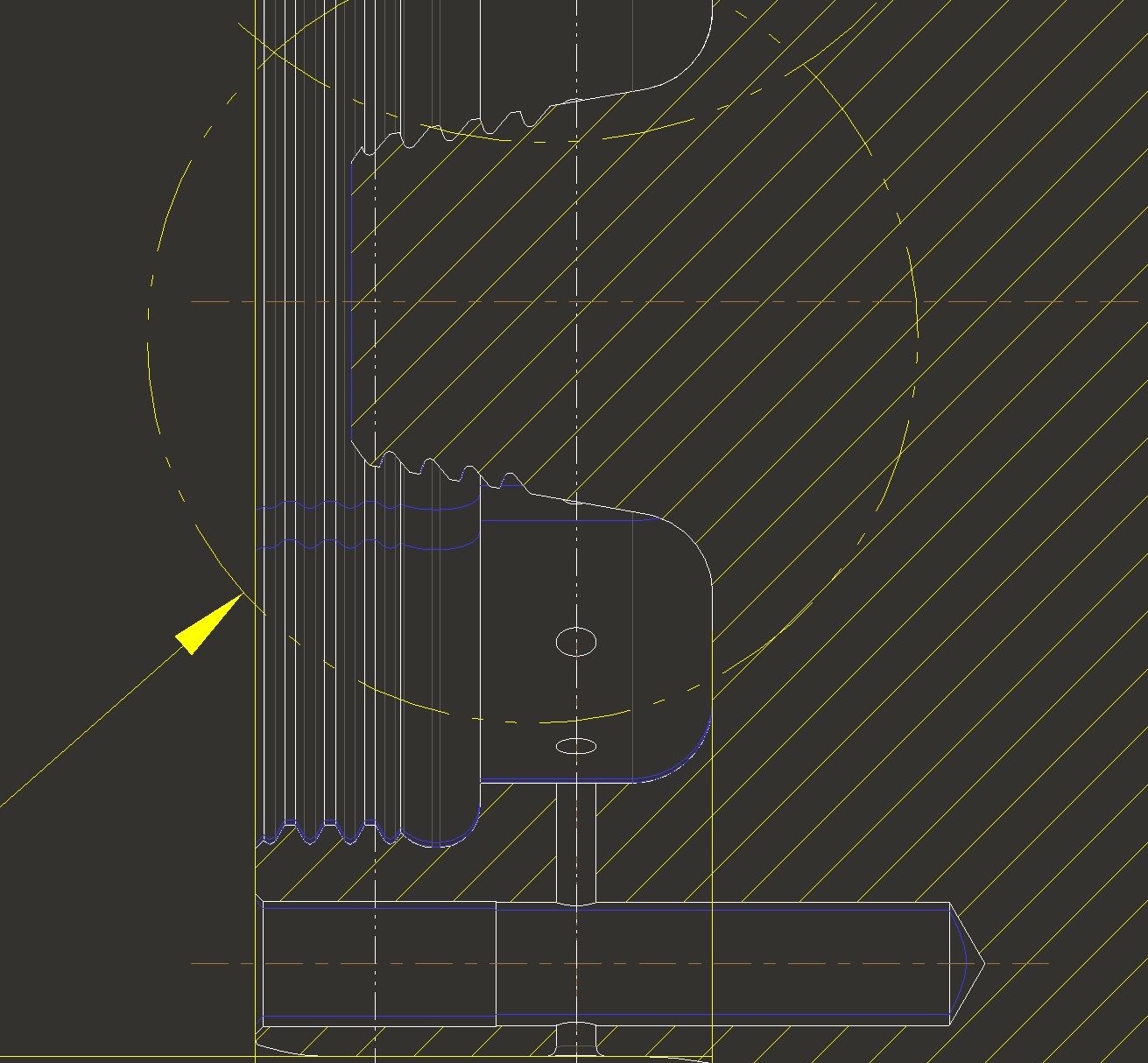

I'm in WF4 and I opened up one of our parts and there were blue lines all over the drawing. I've never seen them before and I can't figure out how to get rid of them. Any help would be appreciated. Thannks
February 12, 2011
Unless there is a problem with the graphics card, it looks like a surface has been created and then the portion is trimmed using the surface. Surfaces and sketches in modeling environment appear blue in drawing. One can select them in the model history and hide them.
Atleast that is what it appears to be.
