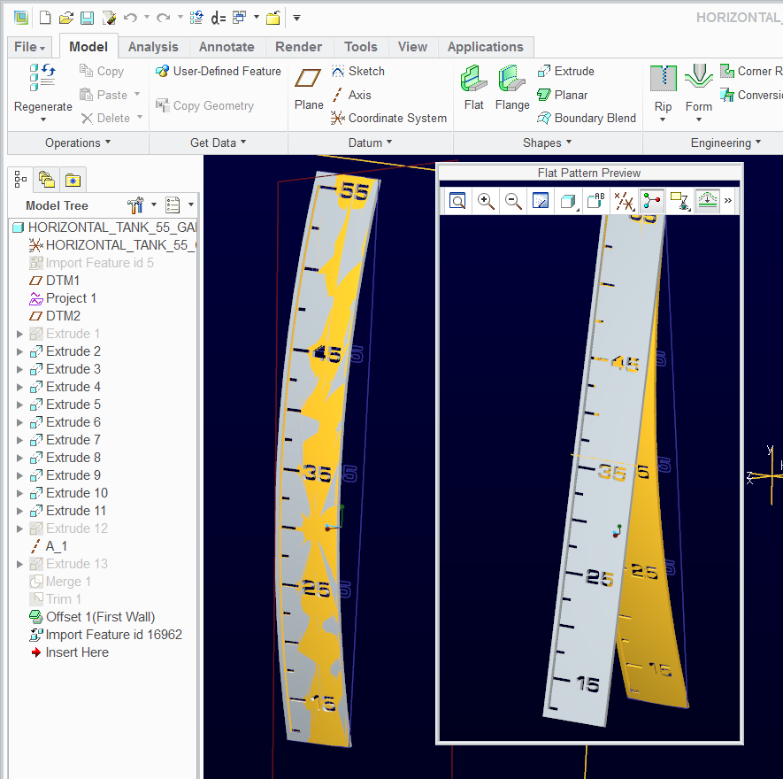

There is no assumption that my version is "accurate" to the original, but the method is sound if you are willing to account for fabrication techniques.
In order to give the second bend, there is metal deformation (coining) of the flat|cylinder orientation.
The "4" character also introduced a second "piece" which is not allowed for flat patterns.  This will have to be joined or otherwise handled separately.
The attached file is Creo 2.0 full version.

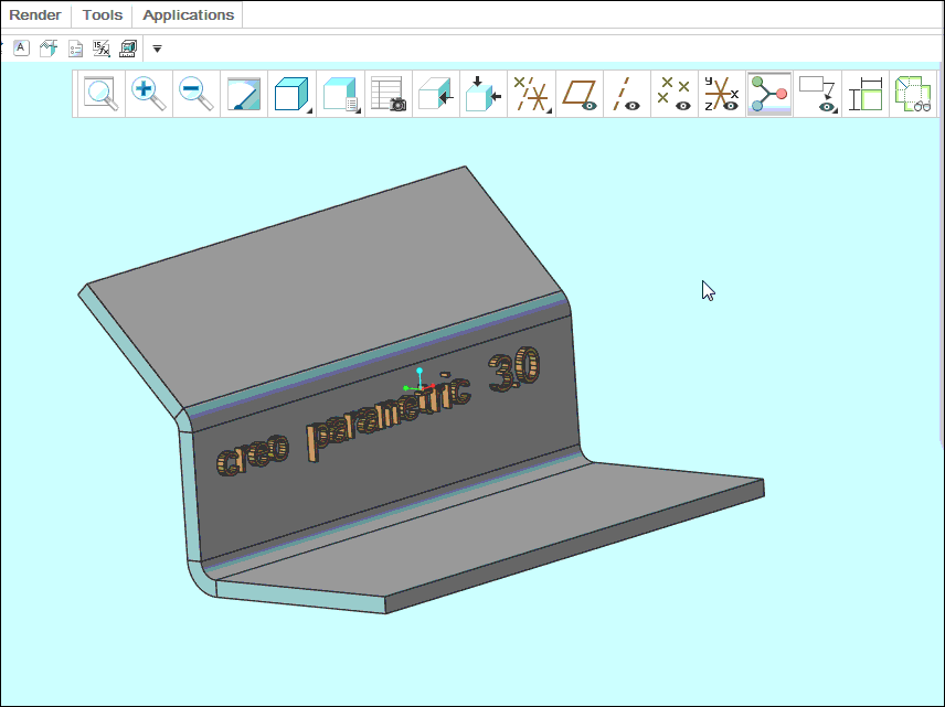

May 28, 2015 11:13 PM UTC

Hello Friends
I can´t unbend this part.
May 29, 2015 1:54 AM UTC
Do you have the original data?
