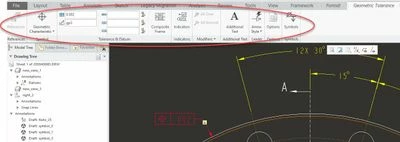

Update:  Ok, I'm ATTEMPTING to make a dwg and it's totally P!$$!NG me off.  As usual, no new features, but they've now buried all kinds of commands inside all kinds of other toolbars/icons etc.  Nothing is where it should be.  Dimensioning totally sucks.  Then I'm trying to put a simple GD&T frame in and What The eFf???  I get some positional symbol with no way to manipulate it???  There's no "properties" pop-up, so how the h3ll a I supposed to get the all-over profile tolerance I need?  If I'd have known it was going to be this much of a PITA I'd have stayed on Creo 3.  What a huge time-waster this interface is.  "Bold New Graphics!" indeed....
Edit:  Ok, I found it.  Whoever thought it would be a great idea to have all your convenient on-screen pop-up menus for dimensions and GD&T be replaced with more ribbon BS needs to be slapped into next week.  In fact, I volunteer to do it...  In Croe 4 now I've go to constantly take my eye off what I'm doing to go look for  something in the ribbon.  Utter garbage.

Once you place the GD&T frame, the options are all on the ribbon.

Yeah, finally found that right after I posted, thanks!  Bad idea PTC.  With a pop-up, it shows up right where your eyes are already looking (i.e. the cursor), and where you expect it.  Now, I have to change my focus to look at the ribbon.  And at 55, I need reading glasses now because I have trouble focusing, so this is more of a chore for me than younger guys, but still, bad idea.  They don't give anything new but just move things around....again, so we have to waste time re-learning the software for something that is actually SLOWER...and somehow it's an "enhancement"?  Plus, it's slower anyways because with the old way, you could specify the frame exactly as desired the FIRST time, not have to place it, then pick on it, then look up to the top left corner.  I swear to God, PTC "development" people don't actually USE the software.  *facepalm*
