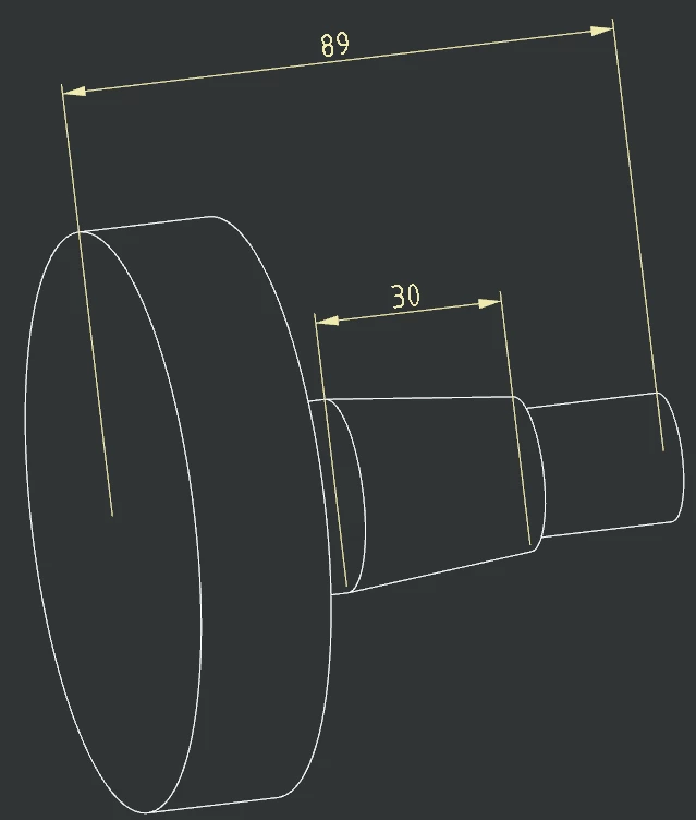

I have made a 3D .PRT model and I want to show it in a 2D .DRW drawing, but using a non-orthogonal view.

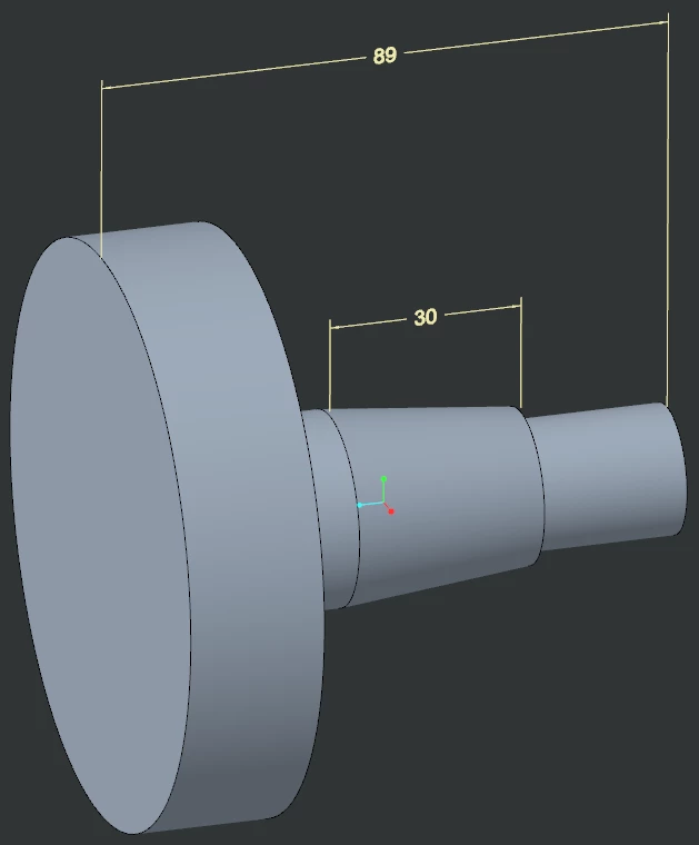

First, I create 3D annotations in the .PRT, using the "Annotate" tab and the "Show model annotations" command. It is important for me to project the dimensions in the correct plane, which I can easily do in the original model (see first image).
Then I create the corresponding drawing. Here, however, when I select "Show model annotations", the dimensions are shown projected along a direction orthogonal to the view plane (see second image). I have no way to edit the annotation plane in the 2D drawing.
Is there any sort of workaround? My goal is to obtain a drawing similar to what I can see in the .PRT (see first image).
