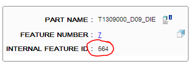

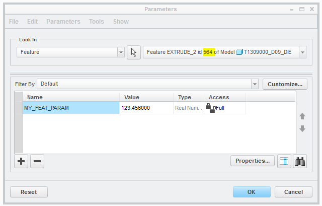

You need to use this syntax:  <parameter_name>:FID_<feature_id>
For example:
April 19, 2016
